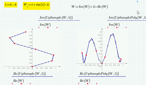

Here is UpSamplePoly based on your idea to use "polyint":
The drawback here is that real parts and imaginary parts are treated differently and so depending on the initial data set it may yield very strange and unusable results.
Try to exchange real and imaginary parts in your sample data -> W:=Im(W)+1i*Re(W)
and see what happens 🙂
Of course things look (a little bit) better if we sort W by the real parts beforehand.
Here is a last version that uses polyint and still handles real and imaginary parts alike.
It may be useful in some situations, less useful in others.
And here is the real last one 😉
I got rid of polyint and replaced it by cubic spline interpolation. This tends not that much to overshoot and is more stable, especially with larger data vectors.
