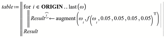

Using the values given (1000 frequency values from 0.1 to 100 with a constant step width of 0.1) I experienced no problems when using the very same guess values (all 0.05) for all of them. Even though these guesses are way off from the actual results. usually its better to use guesses nearer to the actual expected values.
Here I create a table with values using 0.05 as guess throughout.
The table created that way is identical to the table ANS6 created by Terry. There are just tiny differences in the range of 10-20 which sure can be ignored.
See details in the attached sheet where I used Terry's sheet as a start.
This means to me that you could omit the guess values in your function f and use the same guesses (or better ones) throughout.
