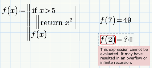

There's at least one thing you can do better. Rename each of those sigma'(z) occurrences inside the program to something else, say R.
As it is now, I suspect the program never ends, because it calls itself repeatedly, recursively.
(To:LucMeekes)

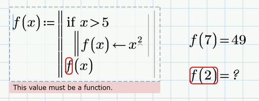

I would have thought so to that this would happen if no local function is defined which is the case for z>z.top[0.
But both MC15 and P11 throw an error in this case:
The error message in MC15 ("Type "2" can not be loaded.") is a bit strange but both seem to refuse to refer recursively to the main/worksheet function if a first pass showed that a function with that name is defined in one of the if branches.
Both programs detect the infinite recursion in case no local function of that name is defined anywhere in the program
Its also remarkable that the first error message from MC15 came in German (the language set in Windows) even though my language settings for Mathcad are to be in English.
So I guess that the program made by @AV_14389071  works OK for him as long as he does not provide a z value larger than z.top_0.
But nonetheless I agree that he should replace the local sigma function definitions for a simple variable or simply do without and use the return statement (which also means that he could do without the if_else and just use a couple of ifs).

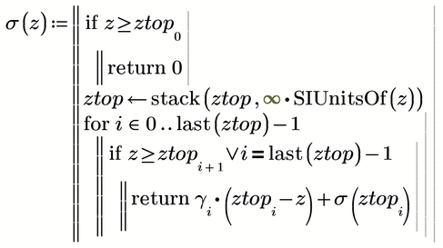

Speaking of recursion, we can use it to make the function definition a little bit smaller which can be especially useful if there would be even more layers:
Or even shorter using a for-loop which works for any number of layers
stacking minus infinity on top of ztop was necessary because Prime unfortunately does not use short curcuit evaluation of combined Boolean expressions.

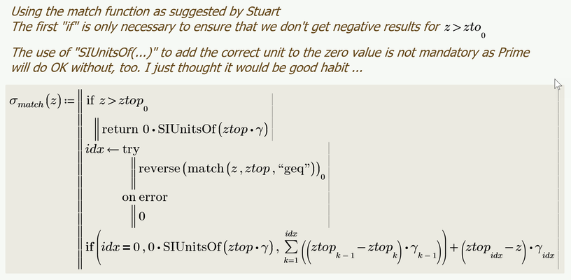

A better option might be determine which layers are below the required depth.  Use the built in function match , for example to find all those layers whose tops are below z.
The use the summation operator to calculate the cumulative stress for those layers (if there are any) and add it to the stress at the bottom of the layer in which z lies.
Stuart
(I’m not near my PC at the moment, and I’ve only got Mathcad Express, anyway. Mathcad Express has no programming, which can make solutions somewhat convoluted for those used to standard programming, as Express encourages functional programming)

And here a version using the "match" function as suggested by Stuart

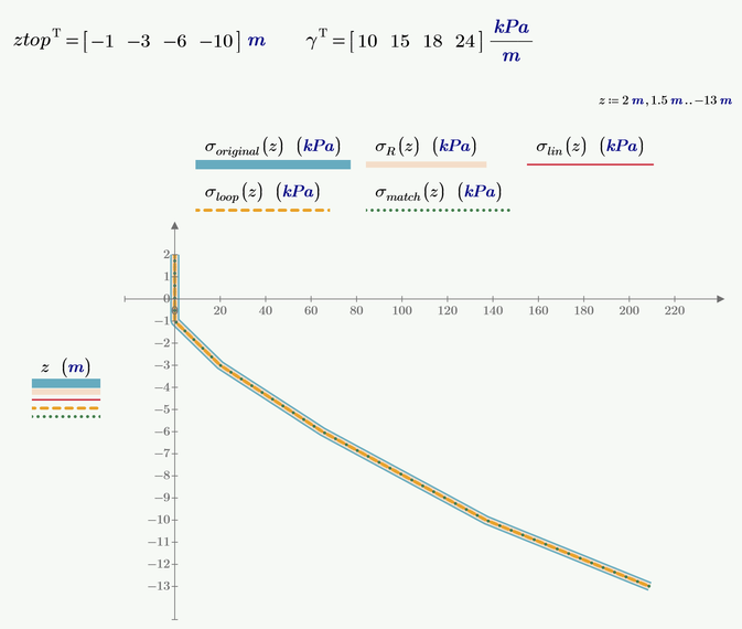

Comparison of the various methods
Prime 11 worksheet attached
