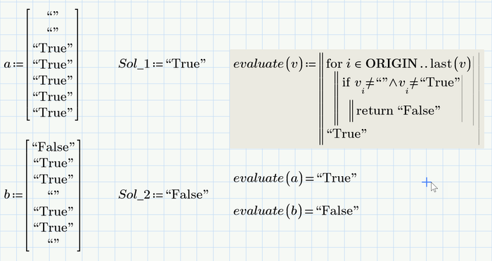

According your Exercise 2 I understand it in the sense that a vector which consist only of strings "True" and/or "" only should return "True" and if the vector contains just one other element (for example a string like "TRUE" or "true " or "False" or " ") the result should be "False.
This could be done that way:
Note that this corresponds to Tetsuro's second version - everything which is not a "True" or an empty string "" triggers the result "False".
His first version on the other hand means that only a "False" triggers the result "False", everything else is allowed and returns a "True".

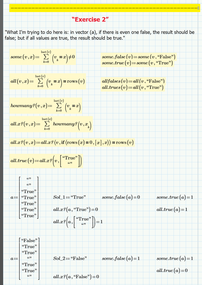

Unfortunately, I'm allergic to something at the moment and struggling to see, so, mea culpa, I didn't get as far as downloading the OP's worksheet and looking at the second example. So, in partial atonement ...
I wasn't sure, upon reading it, what "all true" meant, since some of the values are just empty strings, but Soln_1 is true.
So, I defined a predicate function "all.x?" that checks for all one value or a set of values.
Stuart
