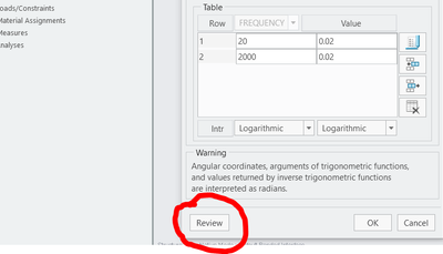

In Creo:
  • Using f(x) and entering the table manually with the launcher-provided frequency points is correct.
  • Enter exactly the breakpoints provided in the specification.
  • Do not over-interpolate unnecessarily.
Tip: Use Review to generate Graph of your inputs
