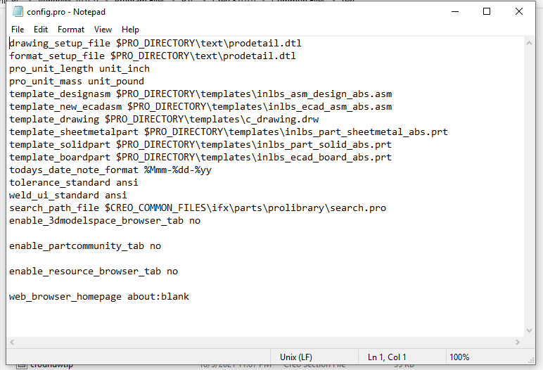

open config.pro file in Notepad and add following lines at the end of the file.
enable_3dmodelspace_browser_tab no
enable_partcommunity_tab no
enable_resource_browser_tab no
web_browser_homepage about:blank
NOTE: config.pro file in my installation is located in E:\PTC\Creo8_000\Creo 8.0.0.0\Common Files\text
