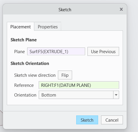

When you create a sketch, the orientation for that sketch view is based on both the reference and orientation in the Sketch Setup.
You can flip this, or modify it based on changing some of the variables in your sketch setup like the Reference or the Orientation. You can access this either upon sketch creation or in the sketch by clicking Sketch setup.
