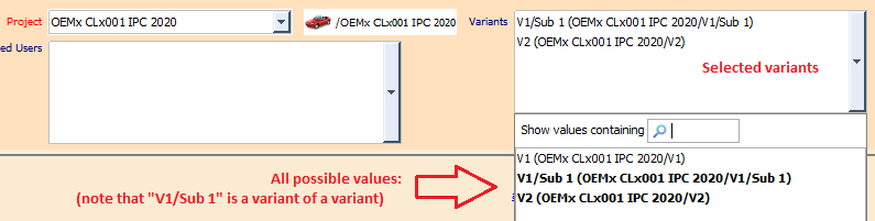

On the Issue type, we use an IBPL called "Variants" that allows to pick any Project items flagged as a variant:
