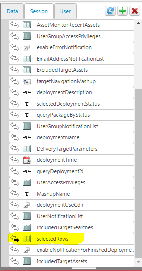

2. in UserManagementSubsystem User Session Shape Settings section, add a new ThingShape "ts1" with only one property "selectedRows" with INFOTABLE type
3.bind the Selected Row(s) to the session's "selectedRows" parameter:

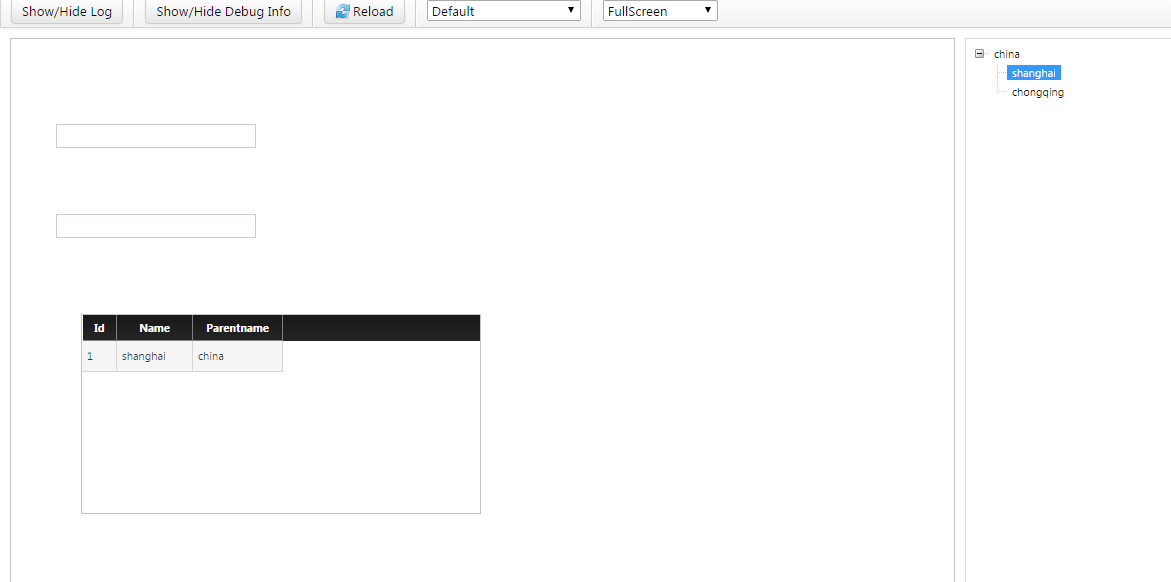

4. Likely, in your parent mashup, bind the selectedRows in session to the widget(e.g., you want to display the selectedRows in a Grid) :
5. view the mashup, you should see the Grid data change accordingly when the Tree table selected rows changed in the contained mashup.

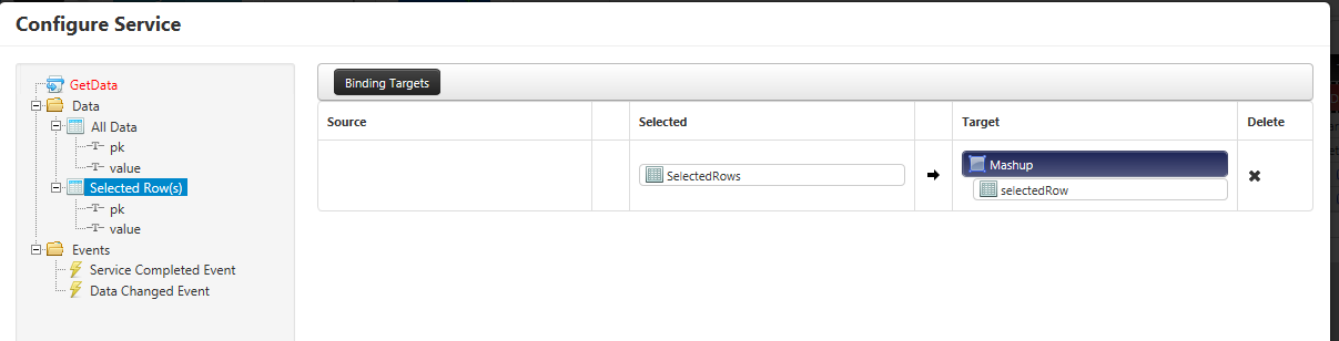

I think the reason I failed to bind Selected Row(s) service to the selectedRows mashup parameter is that I tried to directly drag the Selected Row(s) to the selectedRows parameter, but that's not allowed as they are both out-bound. But if I bind with configure the current entity icon when I focused on GetData(in your sample) binding is allowed. Although I dont understand why, but it did work with your way.

Hi, if you click on the button Bindings in the list of properties of the mashup, then you can bind by dragging the Selected Row(s) from the service to the All Data which is in-bound.
