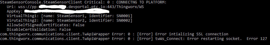

I am trying the SteamSensor example available in the C SDK folder. But on finally running the exe file I get the following error:

The error in the command prompt is highlighting issues with creating SSL connection, it seems to be using the 443 which inherently points to the secured websocket. I've not tried this online guide, will check if there's anything that can be configured there, but could you check if there's any possibility that the pc from which you are executing this piece of code is not blocking e.g. firewall or some anti virus this SSL connection to ThingWorx server.
I turned off the Windows Firewall on my system. It didn't work but the error log changed slightly.
The error now reads: "Error initialising socket connection" instead of "Error initialising SSL connection".

Hmm.. interesting. So if I use the link that you have shared in your above response and if you check the Troubleshooting section the error you are receiving (which has error code of 201) seems to require users to check the websocket configuration. Some questions about your setup

So I tried the above mentioned steps and it doesn't work. Instead it again started giving the previous error: "Error initialising SSL connection" as mentioned in the original post.

No 80/8080 doesn't work. Just checked it. Error: "Error initialising SSL connection"
For using port 80 I used #define NO_TLS statement at the top of main.c code. For using 8080 I changed 80 to 8080 in if/else statement under main() function.

Yes I am building the C SDK example with CMake. My application key had expired. Thanks for pointing that out. But even after correcting it and modifying the main.c by replacing 443 with 80 or 8080 it doesn't work and gives the same error.

It still doesn't work. However if you have used #define NO_TLS shouldn't the port no. be 80/8080 instead of 443?
In any case I tried both the port no. for the above mentioned code snippet and it still gives the same error. In both cases it tries to initialise TLS connection even though #define NO_TLS is used.

Same issue, tried different ports with or without SSL.
With SSL I get:
Error intializing SSL connection
Without SSL I get:
Error trying to connect
I'm using the .NET SDK: SteamSensor example
