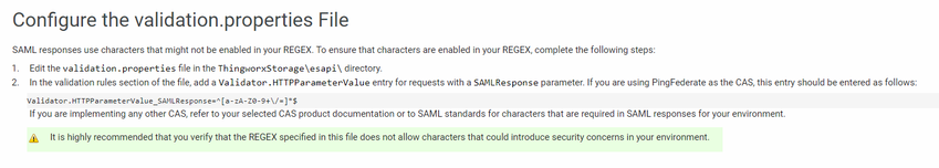

What I could not find out is how the regular expression in "validation.properties" mentioned here should look like for correctly validating the SAML response for Azure AD.
The default REGEX is meant to work with Ping Federate:
Validator.HTTPParameterValue_SAMLResponse=^[a-zA-Z0-9+\/=]*$
Does anyone have a clue if this REGEX needs to be customized to fit for SAML responses from Azure AD? Maybe this helps me to get a working configuration.

I have the same regex in validation.properties Validator.HTTPParameterValue_SAMLResponse=^[a-zA-Z0-9+\/=]*$ and it works fine for me with Azure AD( Without Ping). Seeing your exception, I don't think there is an issue with the validation file, I believe some settings are not correct (most likely on the Azure AD side). I would recommend you to use SAML traces and debug the issue in the SAML response.
