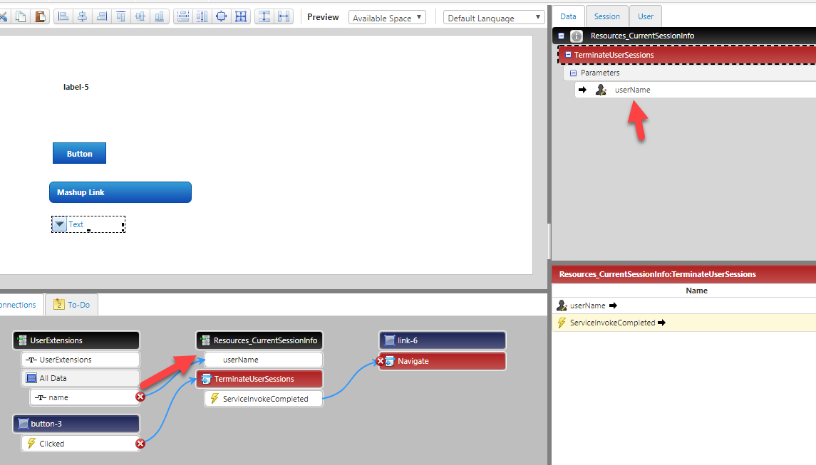

how i create logout service for logout button widget?
Ru
i want to show login page after clicking on logout button
i dont want to show thingworx login popup after clicking on logout button.
refer attachments below for better understand

Hello @Ru
Just like my reply in another post, you can directly add the corresponding resources to your mashup.
Please refer following pics.
BR
Max
