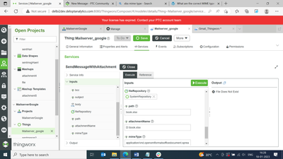

i hava attachment problem came here,
1.error is Unable to Invoke Service SendMessageWithAttachment on Mailserver_google : The filename, directory name, or volume label syntax is incorrect,
2.error is  File Does Not Exist
file is  D:\book.xlsx here location in there
Keep the "book.xlsx" file at SystemRepository folder and try... Please refer attached document
thanks Mr. Sathishkumar, very useful to knowledge sharing. i resolve bugs .
 each file sent before System Repository upload after sent message.
