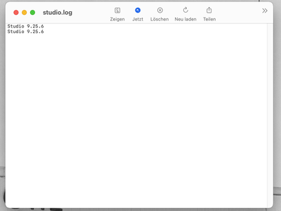

Every time when the user tries to start Studio only one line is added to the log:
