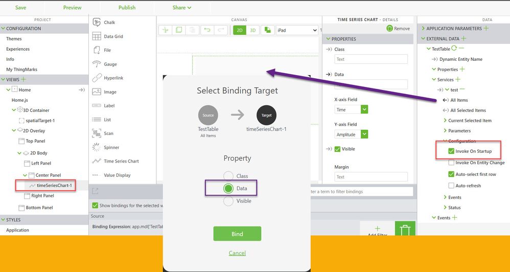

I have an infotable property in ThingWorx and I would like to bind it to the time series chart widget in Vuforia Studio. The data shape of the infotable has 2 fields of type number.
In Vuforia studio I select the infotable from External Data and drag&drop it on the Timeseries widget(and select the Data to bind). However after the binding I am not able to select the X and Y axes and also the chart is not shown when I do the preview( although the visible checkbox is checked).

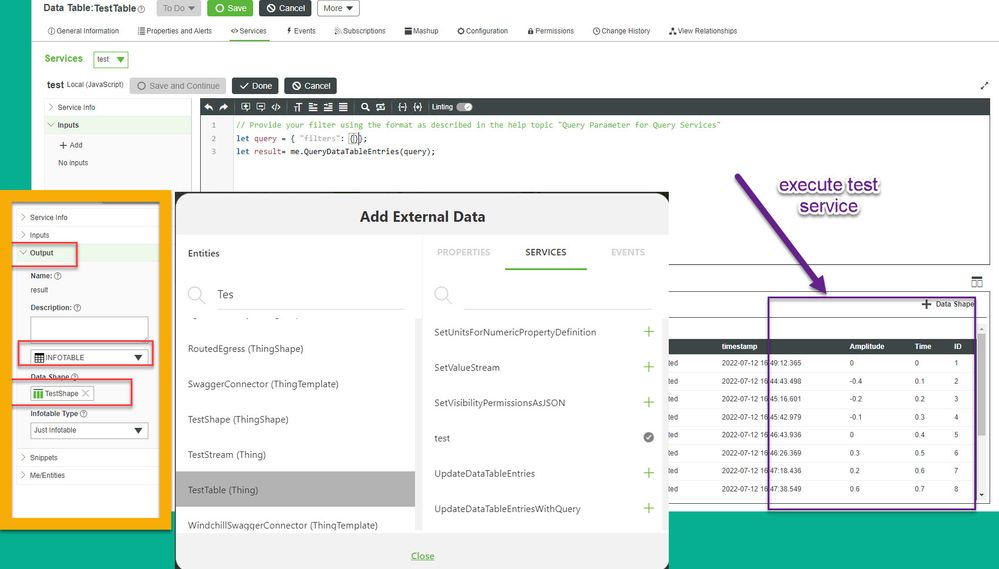

I did not bind an infotable property to Vuforia Studio yet  and I believe it will possibly not work because it is missing the info about the Datashape. This info is required for the widget to select the fields (or to know what field are provided)
But I used in the past a service which have as  output infotable. In this case I easy could test in Thingworx the out InfoTable and also I could specify the DataShape. I tested with DataTable with a method test which simple returns the whole dataTable as InfoTable.
In your case your service simple could return something like - result= me.YourPropertyInfoTable where the input is InfoTable and the correct datashape is specified (picture above)
Then in Studio simple add the service in the external data and bind the test (serivce)  all items to the data property of the timeSericesChart widget:
In this case time and amplitude fields were selectable for the axis of the timeSeriesChartWidget.  And tested in preview:

We followed the steps you have described(see attached screenshots). Now we are able to select the X and Y axes but still the chart would not show up during preview. Are we still missing something?
