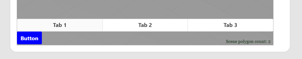

How can I change the background colour of a tab header? (Tab 1, Tab 2, Tab 3 in the image)
'color' has no effect and 'background-color' changes the background of the Tab contents below, not the Tab header.
