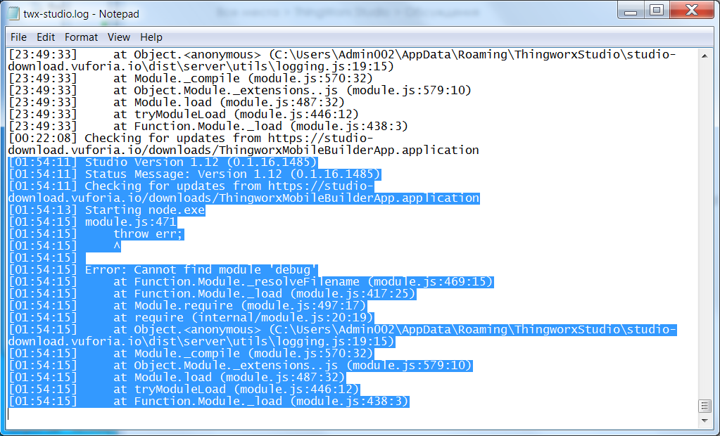

Diownload setup of the available ThingWorxStudio (1.12).
When I start Thingworx Studio I receive the following:
What do I need to do?
It looks like there is an issue with the Node.js application. Have you modified or deleted this application? Please confirm that you have node.js installed and that the debug module is present and accessible. I would also suggest reinstalling Studio if possible.
