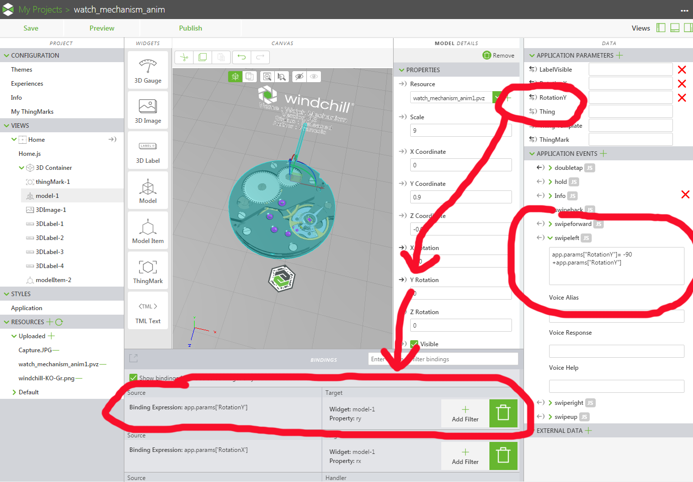

I have used a simple approach to rotate the model .  :
Create Application parameter  RotationY , bind  it with the Y Rotation in the  model
Add JS to for example Swipeleft  event :   app.params["RotationY"]= app.params["RotationY"] - 90  to rotate the model 90 Deg on Swipeleft
