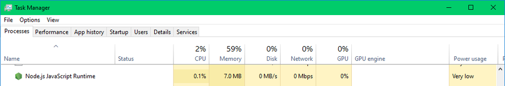

Can you verify that you don't have any other "Node.js" processes running on your machine?

Good morning, I have verified it, I do not have any Node.js process or service running
