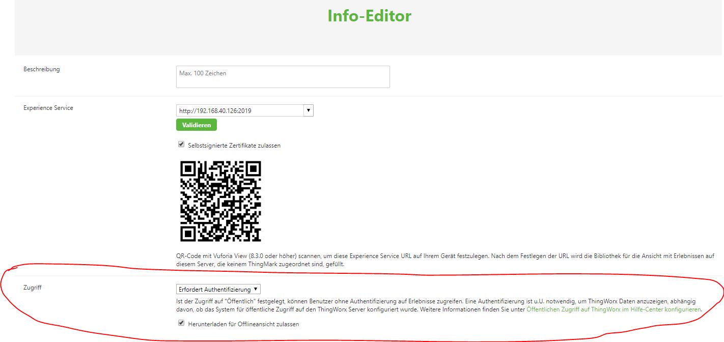

i have another question. I hope i'm using the topic search section right, but i can't find answers for my questions.
When i scan my Thingmark with Vuforia View or when I'm going to Preview in Vuforia Studios i have to Log in with username and password.
I have to this step only once. After i logged in Vuforia Studios and Vuforia View remembers the Log in credentials and i don't have to do this again.
Is it possible to manually Log In and Log Out with different User everytime?
Is it possible to log out automatically after a defined timeout? For example after 10 minutes?

Are users A and B using the same Vuforia View end device (phone, tablet) in this scenario? If you do not enable the 'remember me' option when logging in, then users will be forced to login when viewing any experience that requires authentication.
thanks for your reply.
Yes, user A und B are using the same Vuforia view end device (tablet).
If i'm not enabling the "remember me" option it works. But that is not reallly the solution i was looking for.
I need to manually log out with a logout button or something and a timeout log out after about 15-20 minutes.
Do you have any idea, how to do this?
