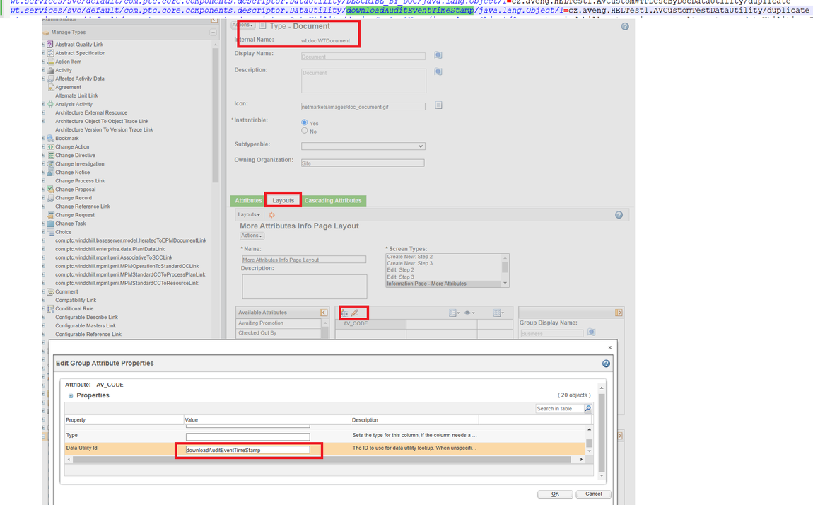

Hi @DKWc
here is an example - I used attribute AV_CODE but it does not mater
here is a configuration and a place where you set the datautility
service.properties
and finally here s a code for DataUtility
