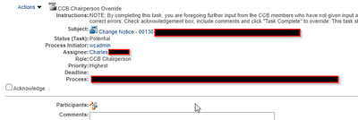

I added this acknowledge check box and a bit of javascript. Does not let complete task button to be checked unless they check the box.
Oh? Using Javascript is an interesting decision. Also, how did you do that? There are places in tasks that accept Java. Where does one add Javascript?
It required using a custom JSP task template. That is where you can put the JavaScript. The next piece was to override the complete button jsp since that is what generates the complete button. Below is from my initial task template:

There is a bit of JSP in the JSP called out above to refer to the javascript function:
if(isShow.equals(Boolean.TRUE))
am = NmActionServiceHelper.service.getActionModel("complete Custom workitem",myNmWorkItem);
NmAction completeTask = (NmAction)am.getActions().get(0);
completeTask.setButton(true);
completeTask.setTitle("Complete");
completeTask.setDesc("Complete");
//completeTask.setEnabled(true);
completeTask.setEnabled((!myNmWorkItem.isCompleted() && !myNmWorkItem.isSuspended() && myNmWorkItem.isMine()));
//addition - Parent JSP page must contain this validtion script
completeTask.setOnClick("validate_Complete()");
actionBean.setAction(completeTask);
NmContext context = nmcontext.getContext();
context.pushElement(myNmWorkItem);
NmAction.actionjsp( actionBean, linkBean, objectBean, localeBean, urlFactoryBean,nmcontext, sessionBean, out, request, response);
context.popElement(); actionBean.setAction(null);
I also had a custom action command inserted for other things.
