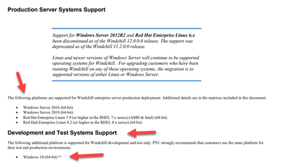

Hi. Do we need Windows server to install windchill ? or will it be possible to install on Windows 10 ?
You can install Windchill on Windows 10 for testing purposes, but it is not supported for a production environment.
You can find this in the Windchill Software Matrices.
