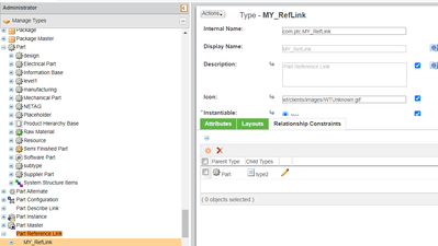

@BenPerry try by creating a subtype of the WTPartRefLink , the new sybtype should reference only your give doc subtype
we can then use the new soft type link in mapping , didn't test this but theoretically should work .
