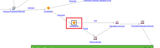

HelesicPetr
(To:N-Pyn)
@N-Pyn
The autorevision is done here in the process>
PetrH
N-Pyn
(To:HelesicPetr)
I just implemented this additional publish expression and tested it. Seems to be working great!
Thank you very much!
