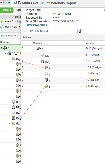

I guess that inseparable is set on the assembly, which should be part of the BOM report. but used parts on the lower level of that assembly shouldn't be part of the BOM report.
I know the case and I don't think it is possible to set it by the filter.
One our customer needed same report with different conditions.
I wrote own BOM report for him.
example what I understood

Thanks för your inputs. Yes, I tried to colapse child components by attribute filering which seems to give correct result. However, when generating the multi level component report, the assembly note is not reported. The report does not treat the assembly with hidden children as a component.

Yeah. multilevel component report
it is different story 😄
It really reports only the lowest children and it does not care about the upper assembly(nodes).
It can be customized
