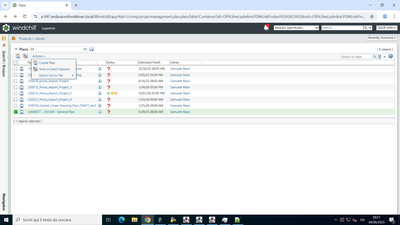

Hello, i'd like to remove Plans from Product -> Plans -> Plan
I have not possibility to delete.
How can i do it?

Hi @FC_9723361
There is no delete function at all in that table. So you can not delete the plan from the product

I think this can be done with Profiles:
You can assign users to a Profile that removes these options.
I'm logged in as Administrator, but i can't.
If you also see in your screen, delete is no available.
You have to assign the people you want to disable (not delete) the plan page for, then edit the profile to uncheck the "View Product Plan" page.

if this is needed for specific products/roles  you can uncheck below from Team> configure action for roles
Fede
There is also a Windchill Preference named Project Planning, Enable Create Plan for Product you can use to prevent unwanted plans from being created.
