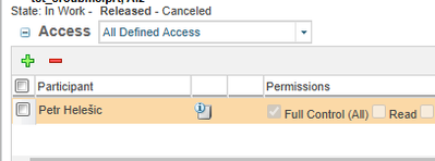

This ACL definition is ok, but you do not know if there are not any others definitions that could involve the results.
So go to the EPMDocument in the draft state, and use a Edit Access Control
Go to the detail info and check the ACL results and share the screen shot.
PetrH

Hi @FC_9723361
Go to the detail of the row by the IHelesicPetr_0-1738139540100.png icon.
You will see where the ACLs are defined....
PS> be careful with Deny usage.
Absolute deny rule on any domain level will not allow to use the revise function even though it is allowed on a lower domain level
Deny rule can be rewritten on the lower domain level but if the Deny rule and Allow rule is on the same level, the Deny rule is applied.
Keep this rules in your mind.
PetrH

Hi @FC_9723361
As I see your ACL rules are set directly on the User
I can not see all the rules defined please slide to the left to see the end of the row
The result is clear. You do not have granted access to the Revise
Check the Lifecycle Access control
it seams that somewhere the access is denied
PetrH

Hi @FC_9723361
I see the root  case.
Your ACL rules define the Deny rules directly on the user. So others rules are rewritten.
The MINUS means Deny. So your ACL definition contains a users level ACL definition that rewrites all upper rules from domains.
Change it and the user will get the Revise rights.
PetrH
