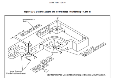

Is it possible to add a Datum Reference Frame CSY to an annotation state? If its not supported now, what work-arounds are people currently using?
To my understanding, the DRF must be displayed in the model IAW Y14.41 (2018) Section 11.2.1. DRF's were optional in Y14.5, but are required in Y41.41.
I haven't been successful with "Reference" feature on the Model Tab, or the "Establish DRF" in GDT Advisor.
Example Image from Creo 12
Excerpt from Y14.41 for example display of DRF's.
