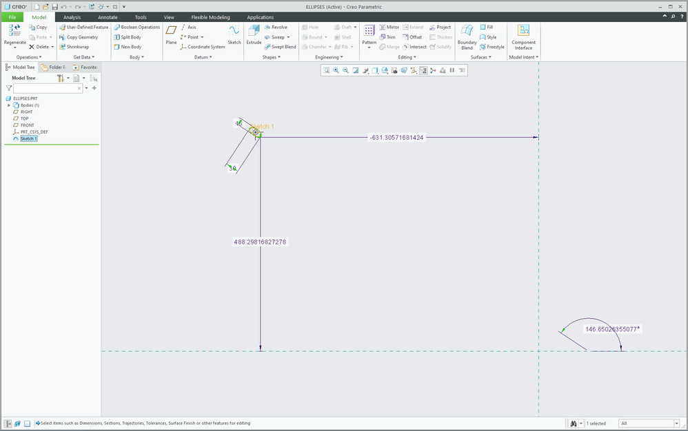

1.]
2.]
create 1st instance
3.]
create pattern ... see attached video
Hopefully it is what you need...
