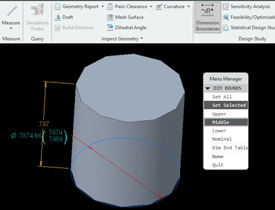

I see.  So sounds like you need to use the Analysis/dimension boundaries function to "force" this dimension to be at the middle value between its limits:
Then you end up with the standard looking shaft fit dimension and also the geometry you want:

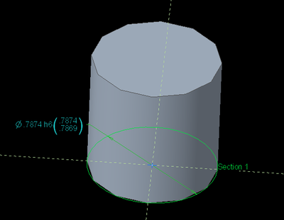

Note in my color scheme, dimensions are typically green, but you can see above it is in the cyan color because I forced its value to be in the middle:
This is the same effect as having maintain_limit_tol_nominal to 'no'. It still does not force the drawing to show the correct limits (0.7874/0.7869)
Peter
pausob
(To:peterbrown772)
? not sure what you mean.  This is the drawing my above example on my system, with a drawing dimension added to show the geometry at the "median value" and the correct limits (0.7874/0.7869) shown.
